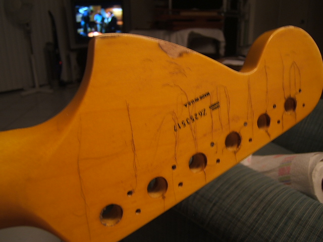

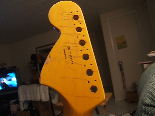

I think I have it...it's cracked/crazed...I listened to the advice of the great minds here at OLF and concluded that I must not be getting the finish cold enough. So I bought more dry Ice and this time sandwiched the headstock between two large chunks of the dry ice ( I put the DI in zip lock bags first and then left a  small opening for the gas to escape). Left it on Ice for 4 hrs. It got so cold that there was frost on the bottom of the table it was sitting on. So then I figured why not give it a little assistance and tap the headstock with my soft head fretting hammer...The finish cracked...I then used a heat gun dried/heated it quickly and traced the cracks with a sharp new razor...re-froze the headstock and did it again...more cracks...but you really had to look for them under a strong light at the right angle...again taced with razor (lightly) re-froze and tapped some more...this time I took some nice medium brown soil from my daughters garden and rubbed it into the cracks...They look pretty good. I think the customer is going to be happy...and that's all that matters right? I'll take some pics and post if they show anything well enough.

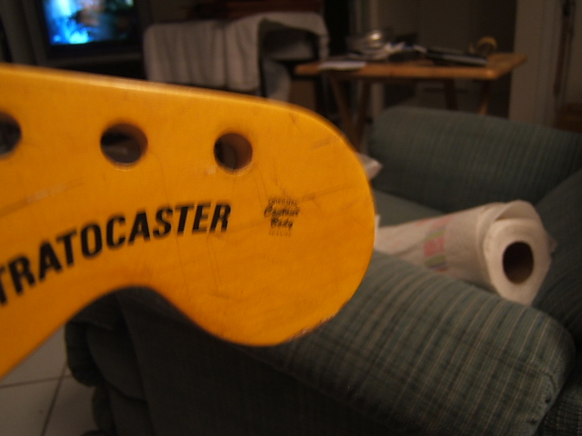

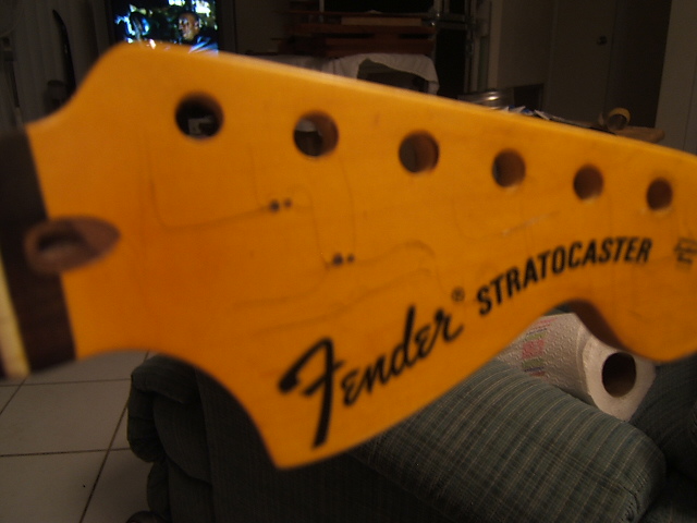

Some pics...

But if you would have asked, i'd have told you to stop when the cracks were barely visible, and not use the knife. Once the finish has split, repeated warming/cold cycles accentuate the crazing naturally. While your work came out very nice, it may have appeared more natural if no knife had been used.
that said, we all forgot to mention that one trick that antiquers use is to use a sharp knife to extremely lightly score the finish, -before- doing the deep freeze/heat cycles. That way, they force the cracks/crazing to eares that would have them first.
Also, the dirt is overkill. Natural body oils(rub your forehead, the side of your nose, whatever, with a finger and rub -that- into the cracks0 lends to a more natural, subtle look that will age correctly in the years to come. Not sure how the dirt will age...

Mario, many thanks as well. I know...after all that...I looked at it and said the front is better because I didn't do the "trace" part. The back looks like overkill...intentional...I know...But like you said I'll know better for next time. I am sure the customer will be happy with the results as the guitar he wants to duplicate is really beat badly and the more natural, subtle look wouldn't havve satisfied as much.

Another wierd note...if you noticed the "chip" on the h.s....I did that by hitting the h.s. with a real hot heat gun...it bubbled the finish...the finish dried, cooled, and then was very brittle...a little finger nail action pealed/cracked it right off. So much for the "tough" Fender finish...
